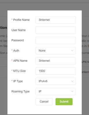

I've had the for about a month now, and everything was working fine until today. Around lunchtime, my internet connection dropped completely. I also couldn’t connect to the Eero device, which pulses white for a while and then turns red.
The Y5 unit only shows a solid blue light—there are no 4G/5G indicators anymore, and the signal strength just says "on" instead of showing a number (0–100) like it usually does. I’ve tried restarting both devices multiple times, but no change.
I’ve logged into the Y5's admin panel over Ethernet, and everything appears fine in terms of settings. I also tried switching the APN from 3internet to three.co.uk, and even did a factory reset, but the issue persists. The inbox for SMS messages now shows up completely empty too, whereas it used to display texts before.
I’ve taken the SIM out and tested it in a phone—it works perfectly, gets 4G/5G signal, and data access is fine. So it’s clearly not a SIM or network issue.
It seems like the hub is not receiving any signal at all. I've seen similar issues reported by other users online—has anyone found a fix for this, or is this a known hardware fault?
Any help would be much appreciated.

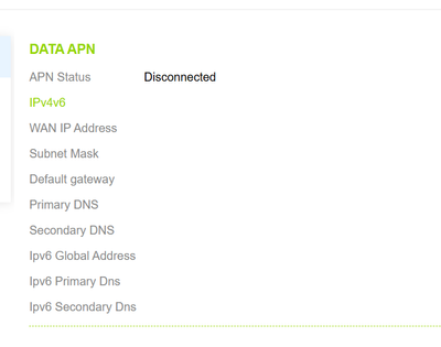

on 07-07-2025 11:36 AM
Hi,
I have the same issue since yesterday. The Greenpacket device fails to connect to the 5G network. Multiple reboots from the web UI did not help. The device shows disconnected APN. Powering off for 10 minutes appears to reset the fault. But same error after a few minutes. The SIM works without issues in other mobile devices. Is there a way to get the device replaced?
Best,
SK
on 08-07-2025 11:54 AM
Hi @SK24,
Sorry to hear that you've been having these issues with your router disconnecting, we can't directly facilitate an exchange from the Community, but the Broadband support page Pete linked has options to call or chat with the team if you scroll down there.
Follow troubleshooting with them, and if they're able to determine a hardware fault they should be able to arrange this with you.
