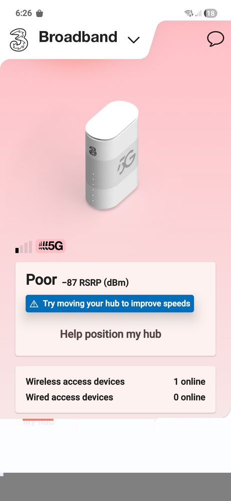

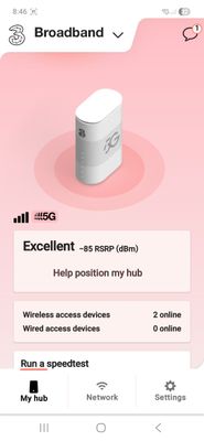

Hi Clive..Sorry for my ignorance,  but I`m a little confused still. When hub first arrived, I fired it up in 3 places...  1st position got 5 white lights, and a blue network light.  So,, I move it to a another position near to front door and got all 6 white,,,.  Then realised my ethernet cables weren`t quite long enough at that position,  so moved again to final position 3. ( on window cill and facing mast direction)  so that, in my mind, was perfect.  and..  still all 6 white lights. ( and the first agent I spoke to last week, confirmed it was facing the direction of the mast )    so, that`s where it has stayed for about the last 8 days.  and all lights have always stayed white. no blue.  As far as I understand,,,  if all lights are white, then that is as good as it gets, as far as ` mast to hub signal ` is concerened.    Now...  regarding the `hub to device` signal, I assume ( but probably wrong) I assume that is what the  Poor / fair / good/ excellent statuses means in the app, the signal from hub to the device .  which is also confusing me,,as the device app has been checked at various times,,  sometimes it states `Poor`,  and sometimes it states `Excellent,`  even though the hub nor device have moved, and all 6 ights on hub remain white.     see app pics

I believe it`s 30 days.  I will check and confirm.    Was I correct in saying the status on the app ( pics) is the signal strength between hub and the device ?.
None of it makes any sense to me. lol.  I can check it one minute and it states " poor" ,,, then check again without even moving the device,,,  and 10 seconds later it`ll state " Excellent" ,, then when I run speedtest,,, there doesn`t seem to be any difference in speeds, whether it is in a ` poor`  or an `excellent` state  .  So really,  the app signal status tells me nothing,   and the 6 white lights on the hub tell me nothing.   also,,, ( lol )   the upload speed is nearly as  `fast` as the download.   latest example was...   55  up ... 49 down.

The app screenshots look to be indicating the cellular signal, but the fact you are seeing it switch between different signal levels in the same physical position is a bit strange, it looks like it is flicking between different bands.  Does the speeds fluctuate as well?  Maybe try downloading a large file and monitor the speed over a period of time.  The router might be switching bands based on through-put.  Some speed tests download and upload very small files, so the router doesn't get time to "rev" up and connect to additional bands in time.
