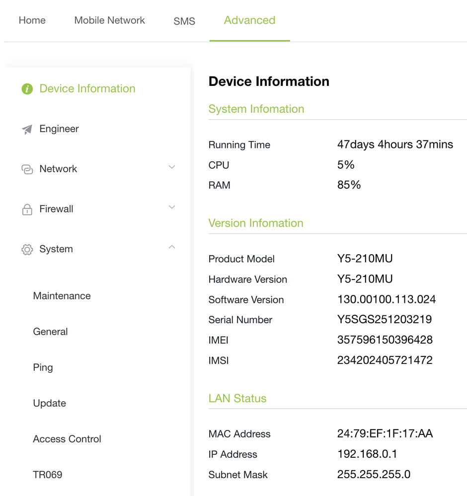

Here is video evidence that TR069 can't be disabled (at least not by clearing the acs username as you claim): hxxps://imgur.com/a/Ni1qNT0 (replace hxxps with https)
Do you have video evidence that it stays disabled after a refresh?
EDIT: Wait! I could disable it by NOT clearing the "ACS User name" field (if that's what you meant then my bad). I'm now curious if "cwmp" will still show in the logs. I note that I now have 47+ days uptime, see below. I did have one downtime last week where my Asus router couldn't see the internet any more, but it came back up by itself, so that likely was the actual 5G connection dropping. What I do have now every couple of days are short 10-20 seconds slow-downs, as if the bandwidth suddenly drops to 1mbps then recovers.
I made other changes to my setup (the TR069 stuff wasn't disabled) which I detailed in other replies in this thread (see here and here), particularly a high quality aftermaket PoE injector with integrated switching power supply. The firmware version didn't change, so either Three has made modifications remotely to the hub in the meantime (very unlikely from what Johnathan reported in a private discussion), or one/more of my changes made a difference.
