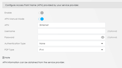

Same here. Solved it just now by switching APN to manual and selecting PDP Type - IPv4

This will depend on your device where to find the settings, but you can usually find initial instructions to login to router admin on our Device Support pages. E.g. this is the page for the Zyxel NR5103E router.
Under popular topics, there's info on how to "login to the router management interface."
Assuming this is the same model of router, once you're logged in the APN settings are found under Network Settings > Broadband > Cellular APN, then you should have the options to edit this as described by @Theodore.
