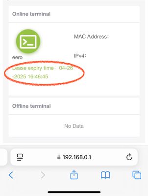

I’m not the most technical but wondering if it’s the lease expiry that’s adding to the issue?
JohnR
Active
It's the ethernet link that is going down, the same as if the Ethernet data cable was physically unplugged for 30 seconds then plugged back in (it's still getting power as it's using PoE, it's just cutting off data).
If there was a DHCP lease expiry from the Three DHCP server then that would not be an intermitted issue like the one I described, and it wouldn't have any bearing on the ethernet link state
