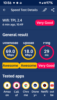

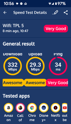

2nd option on the TPLink video worked fine and I now have superb coverage throughout my home. Quite surprising the speed difference between 2.4 and 5g bands but massively pleased. Will leave connecting to Sky Q til a later date. Thanks for your excellent help, very much appreciated.
