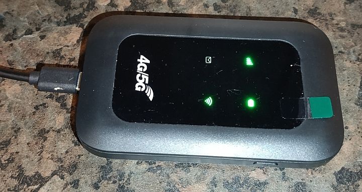

I managed to try another cheap MiFi device and get it working on Three 😁
I am using the MiFi to provide a secure connection to a Raspberry Pi server and so far it looks to be very reliable with a good/stable 4g connection.
The one I got was from eBay but below on AliExpress looks like the same model. Note: It is NOT 5g, just 3g & 4g
https://www.aliexpress.com/item/1005007317217204.html

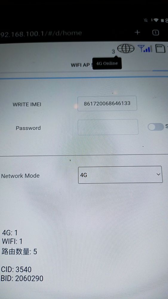

Connect to the MiFi and access router at: 192.168.100.1 see router for admin password.
The Three settings were:
AP: three.co.uk
IP: IPV4/IPV6
Network mode: 4g
Everything else, eg user/password blank
Works fine on Three network 😎
Hope this helps anyone else after a cheap MiFi solution 👍
cheers,
jamie

Really great info and spot on with the APN settings, I'd just add that the APN 3internet may also work better as an alternative for Broadband purposes.
I've not allowed one of the screenshots as there was an IMEI showing, it's best not to share that ID for your device from a security perspective. I don't think the lack of that image will stop others from following what you posted though. 🙂
