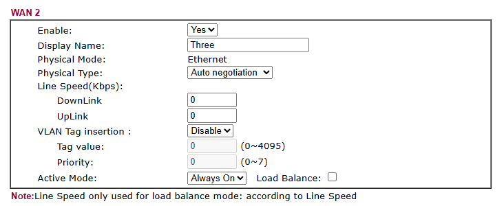

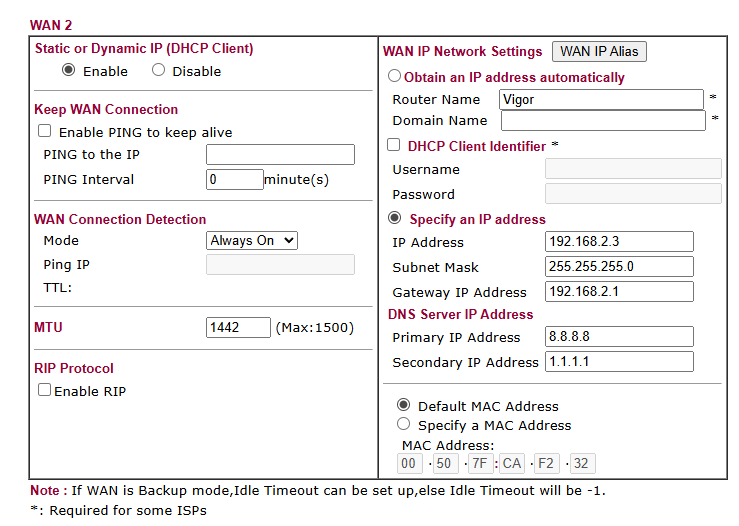

Now I attempt to connect my DrayTek router to it through the secondary WAB port, I enabled WAN 2 in the internet access setting, I set the connection to always on, specified an IP, Subnet Mask, Gateway IP, DNS server, all that good stuff - all looks good!

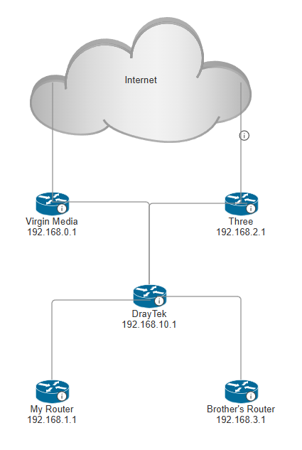

The current system that I'm working from is Virgin Router + Three router for internet
DrayTek router for failover (also will be doing L2TP to an external server so failover doesn't change my IP address)
My router and my brother's router for our own devices
What am I doing wrong here?

Here's WAN 2's setup
Wan 2 enabled is Yes, Display name is Three, Physical mode is Ethernet, Physical Type is Auto negotiation, Active mode is Always onWan 2 enabled is Yes, Display name is Three, Physical mode is Ethernet, Physical Type is Auto negotiation, Active mode is Always onWan 2 is enabled, WAN connection mode is always on, the specified IP address is 192.168.2.3 with a gateway IP address of 192.168.2.1Wan 2 is enabled, WAN connection mode is always on, the specified IP address is 192.168.2.3 with a gateway IP address of 192.168.2.1
