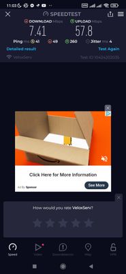

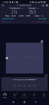

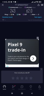

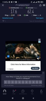

on 07-10-2024 11:15 AM
Hi Pete,
Current test just on phone as still ill, sonobv subject to WiFi/phone limits but even so trying with VPN yields similar relative results
Without VPN
and with VPN
