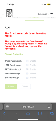

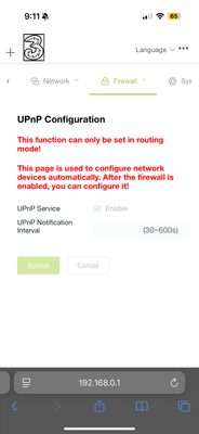

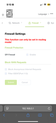

Try these settings. You will need to connect to Outdoor via Ethernet and log in as Admin. Change net mode management from IP Passthrough to routing to apply these. Once done change back to IP Passthrough and plug the ethernet cable back into Eero.

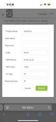

There many posts around vpn issues particulary with a couple of brands... some people try to use three.co.uk apn instead of 3internet and set it to ipv4. Have you tried this?

I haven't tried that suggestion you have said - I am not sure if I can using the EERO app, but I'll give it a go and report back!!
