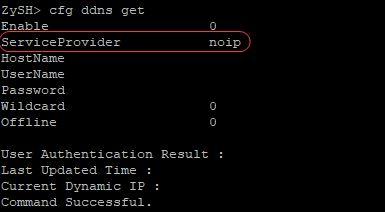

I would like to set up Dynamic DNS for remote management or to reach a server running inside my network from outside, using a third party service like NoIP
The admin web interface does not have any section about it, however logging in to the router via SSH, it seems it is possible to set it up as there are commands about it, for example
[email protected]'s password:
ZySH> cfg ddns get
Enable                    0
ServiceProvider
HostName
UserName
Password
Wildcard                  0
Offline                   0
User Authentication Result :
Last Updated Time :
Current Dynamic IP :
Command Successful.

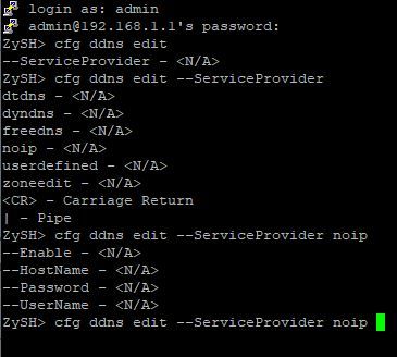

there is also a cfg ddns edit command but is is not really easy to figure out what syntax & input it expects.

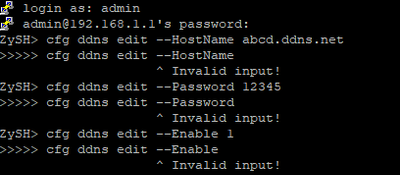

Not sure what I am doing wrong here. I keep getting " ^invalid input! " apart from cfg ddns edit --ServiceProvider
AKJR
Solution is put all your details into one line as usernamefor3 suggested
cfg ddns edit --ServiceProvider noip --HostName <hostname> --UserName <username> --Password <password> --Enable 1
Then add a " ? " to the end then hit enter.

Hi everyone, has anyone managed to successfully get the userdefined DDNS working on this router? Trying to get it working with DuckDNS.
In the past I got noip working using this syntax:
Setting the ServiceProvider to "userdefined" and sending a ? to get the next accepted command seems to work well resulting in this:
cfg ddns edit --ServiceProvider userdefined --ConnectionType HTTPS --UpdateURL <Update URL>
however sending a ? here results in the SSH session being closed. Completing the command here is accepted but it doesn't seem to work.

However, if you type a after typing a command there is some sort of inline help which expands showing what the next expected parameter would be. Surely does not replace a proper documentation, however I managed to get to a working command for noip:
That works. Checking on NoIP side it looks like it gets updated every 24h at 0.20 BST

I'd also like to add you have to enter the switches one at a time. You can't use that command all at one.  So  etc:
cfg ddns edit --ServiceProvider noip --UserName <username>
 I was able to add DDNS for noIP in this way.

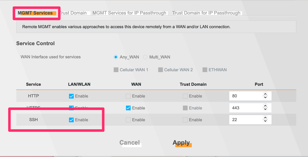

ajay_falcon
Hi gianpaolom,
I am trying to configure DDNS. How did you ssh into the router? I get a timeout when I try.
ssh [email protected]
ssh: connect to host 192.168.1.1 port 22: Operation timed out
cheers.
Ajay
bigkahuna
Regular
Remote ManagementRemote ManagementMake sure you've enabled SSH access on your LAN/WLAN.    I've used the same approach to get access to CLI and I've now added noip as my DDNS.    I've also enabled HTTPS on the WAN so that I can manage the router remotely.
