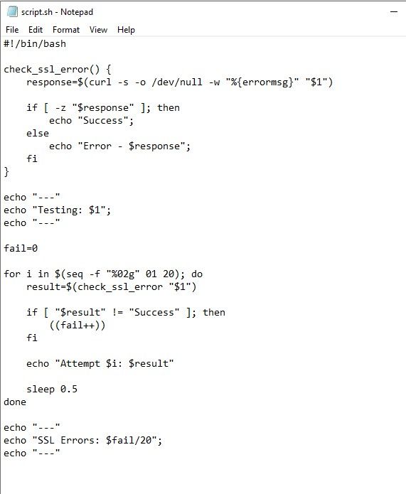

If anyone wants to check this issue, they can run this script I've done to check if a website is affected.
Bash and curl are required.
Run it as follows:
$ ./script.sh https://www.topcashback.co.uk
#!/bin/bash
check_ssl_error() {
    response=$(curl -s -o /dev/null -w "%{errormsg}" "$1")
    if [ -z "$response" ]; then
        echo "Success";
    else
        echo "Error - $response";
    fi
echo "---"
echo "Testing: $1";
echo "---"
fail=0
for i in $(seq -f "%02g" 01 20); do
    result=$(check_ssl_error "$1")
    if [ "$result" != "Success" ]; then
        ((fail++))
    fi
    echo "Attempt $i: $result"
    sleep 0.5
done
echo "---"
echo "SSL Errors: $fail/20";
echo "---"

I've just enabled dev mode and enabled linux for windows, installed ubuntu but I seem to be getting the following error when running "./script.sh https://www.topcashback.co.uk".... any ideas?
I'm not familiar with linux much however
./script.sh: line 2: $'\r': command not found
./script.sh: line 3: syntax error near unexpected token `$'{\r''
'/script.sh: line 3: `check_ssl_error() {
Midnight54
Established
to answer myself - figured out, have to convert with dos2unix to get rid of carriage returns (how archaic for things to be so fussy 🙂
However - as of right now - I'm trying it and its not giving me errors - router has been not been rebooted and uptime of 43hours - so wonder if either coincidence, or the issue lesser later at night, or if something has changed over the past hour or so while I've been messing about - as at mo touch wood the websites i'm trying are working
