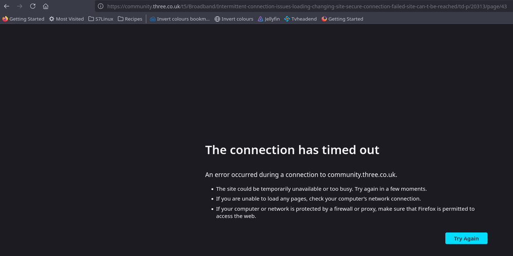

If it helps any (ha ha,  good one!), this is what I get when I try to connect to this very page without my VPN active. I know this doesn't appear to be an issue that impacts anyone else, and may even not be related.... but not being able to connect to my own ISPs site without a VPN is pretty much the definition of tinpot
