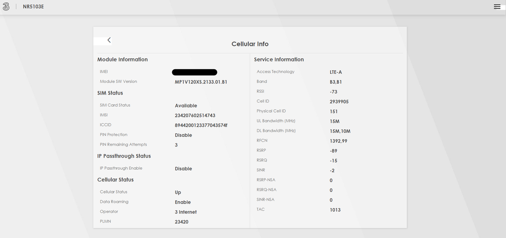

Could you please share a screenshot of the Cellular Stats page from the NR5103E admin portal? Just want to have a peek at your signal stats (RSRP, RSRQ, SINR etc.) and see what Cell ID you are connected to to check it out on Cell Mapper.

on 04-02-2023 12:11 PM
Hi @crypt0ninja
Thanks for your reply and help.
I have checked the Three Status Checker but it says "Our systems haven’t reported any network problems."
I have attached the screenshot of admin portal.

on 06-02-2023 10:50 AM
Hi @halfur,
Looking at your signal stats, whist you have good signal strength your Signal/Noise Ratio (SINR) is not good at all at -2 and could explain the poor speed as the antenna is essentially picking up more noise than signal of use.
In my opinion, for a good connection SINRs should be between 5-10, for an excellent connection then 15+. A negative SINR is not good at all.
I would advise to try various locations in your property to determine the location that gives you the best SINR value as there could be something within the routers surroundings that's affecting the noise levels.
I have looked at the mast you are connected to via Cell Mapper and it looks like that mast has B1, B3 and B20 so might be worth trying to add B20 into the mix also to see if that helps with your speeds.
Also, it looks like there is another mast very close to the one you are connected to in the attached pic that only has B1 and B3 so I guess there's a possibility that the router has switched mast as they are close to each other. Only way to specifically lock onto the specific mast you want would be for us to have Cell locking options available in the admin portal but it seems Three have Cell locking options restricted at the moment and only allow us to Band lock with the NR5103E (we've requested for this top be added in a future firmware update if possible).
Hope this helps!
