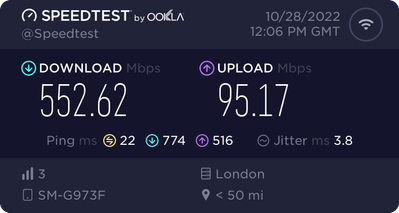

I then purchased a 5G Hub from Vodafone. I got twice the speed than on the Three network. But I was curious what would happen if I insert the Three SIM card in that device. And here are the results:
Download speed: 550mbps
Upload speed: 100 mbps
Guys, my device is faulty. I cancelled but really wanted to make it work. I even told you in my chat with your technical support agent that I would be happy to try one last thing before cancelling, and that is to swap my hub with a new one. You refused to do so. Why?!
So now it is clear that I definitely are within the 5G range from my home. I know there is nothing wrong with your network. And I am now certain there is something wrong with the device you sent me.
Here are some test I made this morning. Same SIM card (Three), different Hub (Three, Vodafone), same external antenna.
Network: Three
Hub: Gigacube (Vodafone)
Antenna: External
8790464410
Network: Three
Hub: NR5103E (Three)
Antenna: External
8790452188
I am happy to remain on my plan with Three, but you need to admit that the device you have provided is faulty needs replacing.
