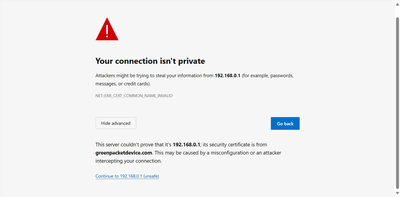

I can’t seem to open the IP link https://192.168.0.1/
MymsMan
Rising star
Is the hub not at that location or is your browser raising a security exception?
It is normal to get  a security warning when accessing local web pages and it is quite safe to ignore the warning (there is normaly a not too obvious link or button on the warning page)
eg for MS edge:

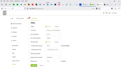

Reset (not just reboot) hub, if that doesn't help, Try:
  • log on to to hub https://192.168.0.1 using userid admin and password printed on hub label
  • Navigate to Advanced->System->TR069
  • Disable TR069 and Periodic Inform
  • Submit, if that fails with a red message then clear 'Request user name' field and try again.  Do Not clear 'ACS user name' field
  • Navigate to Advanced->System->Maintenance
  • Disable Scheduled Reboot or change to a less frequent interval (days)
  • Click on Scheduled Reboot
