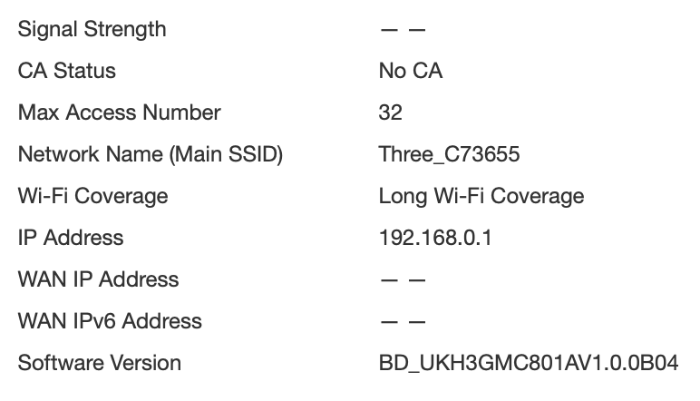

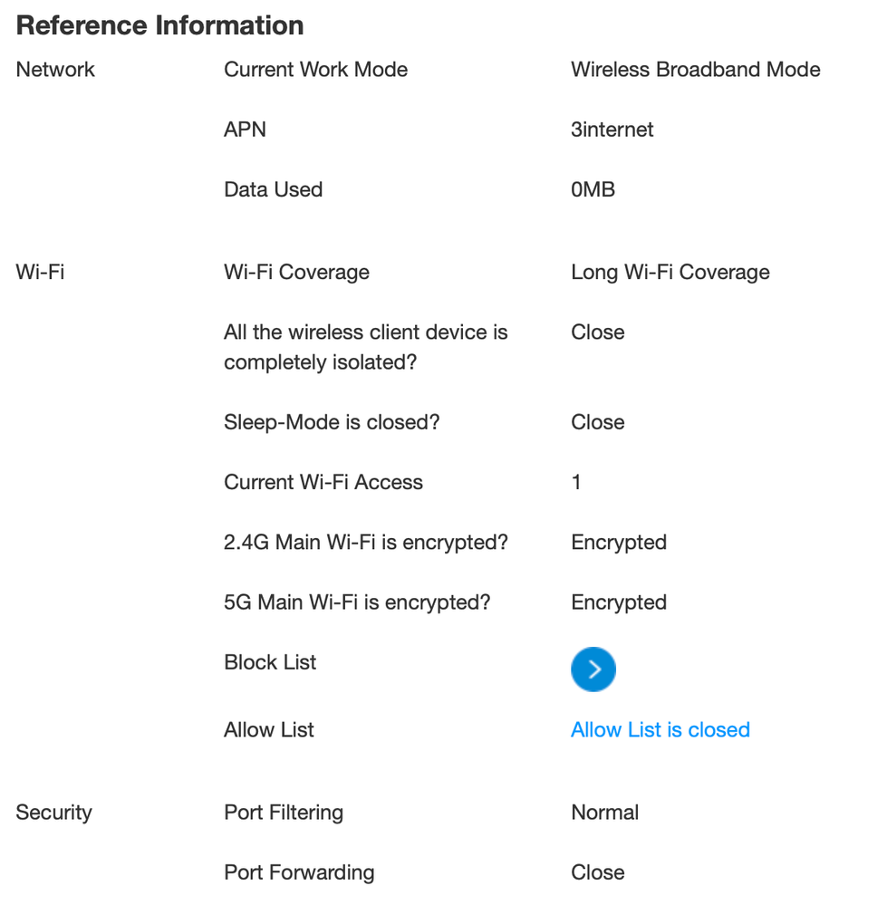

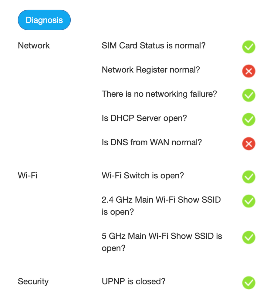

I recently bought the ZTE 5G Hub but it looks like there's a network issue with the router. The SIM I was provided with for the router works fine for internet connection on my phone but there appears to be a network issue only when I try to use it in the router (I get the red light status for Network).
The in-store and phone people haven't been very useful and in some cases stumped over what the problem could be. The router's software version is currently BD_UKH3GMC801AV1.0.0B04 and here's a few screenshots from the login and diagnosis pages. Help?!

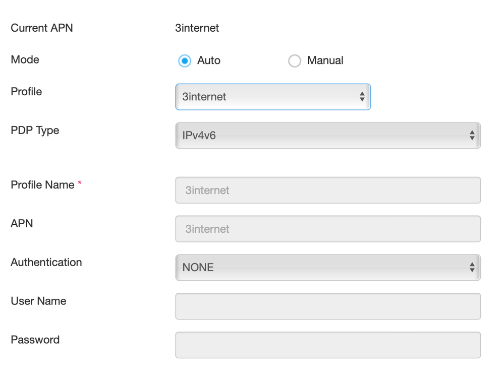

Can you reply with a screenshot of the APN settings on your router?
Unfortunately I cannot see those images you've uploaded...
on 09-12-2022 11:24 PM
Ah that's weird, sure here you go. Lemme know if it isn't visible:

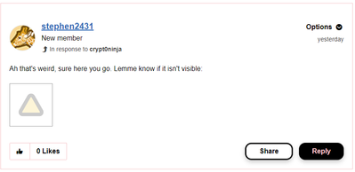

on 10-12-2022 11:50 AM
Still cant see it 😅 not sure if its just me?

on 10-12-2022 11:54 AM
Hey.
Yeah, the screen grabs seem to be loading up OK for me.
It looks like it's configured normally. Quite strange.

on 10-12-2022 12:44 PM
This is all I see:
I use Brave Browser (based on Chromium) but also tried the built in Microsoft Edge browser and also tried my iPhone (both on and off home WIFI) but same thing on all of them...
Weird lol
on 13-12-2022 02:52 PM
Hey @crypt0ninja, @stephen2431,
Sorry if this caused any confusion regarding screenshots. We have to approve them, just in case, we try to keep on top of these as much as possible but you may see a little bit of delay in images being approved over evenings and weekends. 🙂
