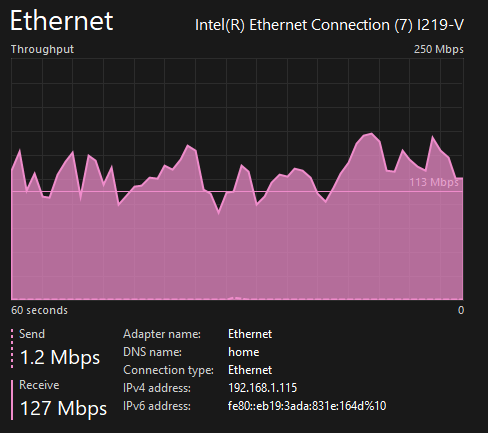

Hi, I'm assuming you are getting 700-900 Mbps when you performed a broadband speed test? I get similar from my router, 700/75. It seems your internet connection is fine, so it could be the LAN side that's causing the problem. It could be your PC adapter? How the router Wi-fi is setup. Are you connecting via Wi-fi or cable? Are you running Windows 10?
In Windows, you can perform a simple throughput test by downloading a 2GB movie from Amazon/Netflix and monitor the speed from Task Manager > Performance > Ethernet (IP your PC is using). You will see the average throughput ramp up. I get around 300Mbps average with a simple Cat5 cable and is connected to the router at 1Gbps speed.

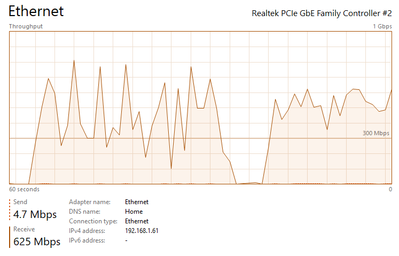

Hey there, thank you for your response, I think we are in the same boat in terms of set up. I have downloaded a Netflix movie and posted the results.
I seem to get a great load of speed at the beginning of the download and continuously drops. I am using an ethernet cable similar to yours also, this test was repeated a few times with the same result. (PC Netflix App)
I'm having trouble uploading the photo of my results. The film was 2GB in size and started swiftly at 500mbps but decreased continuously throughout the download

I'd suspect (but have no way of knowing) that there's a bit of traffic management going on here.
This will be being done to ensure that all users get access and that neither the fronthaul (between your device and the antenna panel) nor backhaul (link between the base and the rest of the network) becomes overloaded (it can happen but such measures are put in place to try to mitigate it)
A file download isn't time critical like a VOIP call, video call or gaming traffic is so it's priority will be lowered, how much by will depend on the detected load, if things are quiet, you'll likely get faster speed, if it's busy, your download will be slower.
While you could argue that you getting your download done quickly is beneficial to the network, if enough people do the same, things could quickly grind to a halt.
