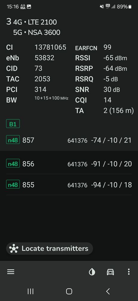

on 26-11-2024 10:46 AM
Look like Three 5G has switched on now. but speed capped at 100Mbps down and 50Mbps up at the moment from Aqueduct, TF4 3RR
CI: 13781065
eNb: 53832
CID: 73
TAC: 2053
PCI: 314
BW: 10+15+100 MHz
EARFCN: 99
RSSI: -101 dBm
RSRP: -99 dBm
RSRQ: -9dB
SNR: 4dB
CQI: 13
TA: 13 (1.0 km)
Band: B1, B3, n48 (4G LTE 2100 + 1800) (5G NSA 3600)

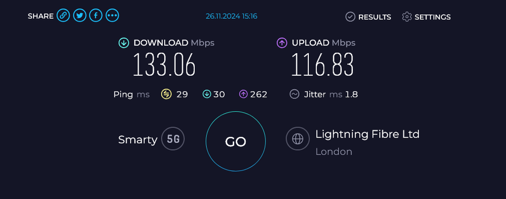

on 27-11-2024 12:37 PM
@JonathanBThe mast went live yesterday or day before.
site might be waiting for upgraded network connection, could be on a 4G era 1gigabit link and waiting for the telco to upgrade to 10 gigabit.
I just got back from Aqueduct, download 145Mbps upload 155Mbps stood next to the 5G mast using 5G.
I changed to 4G LTE, download 80Mbps and upload 110Mbps.
I think you are quite right, the mast must be on 1gigabit link for now.
