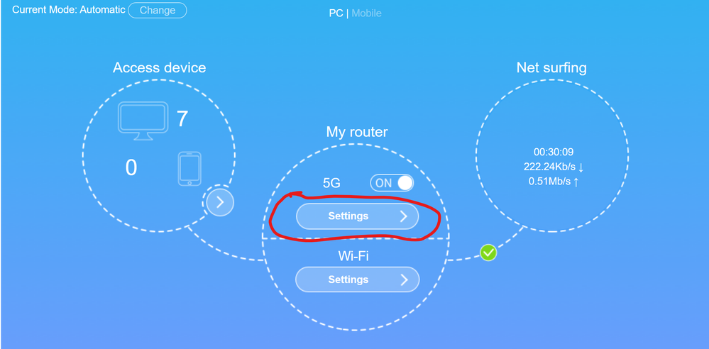

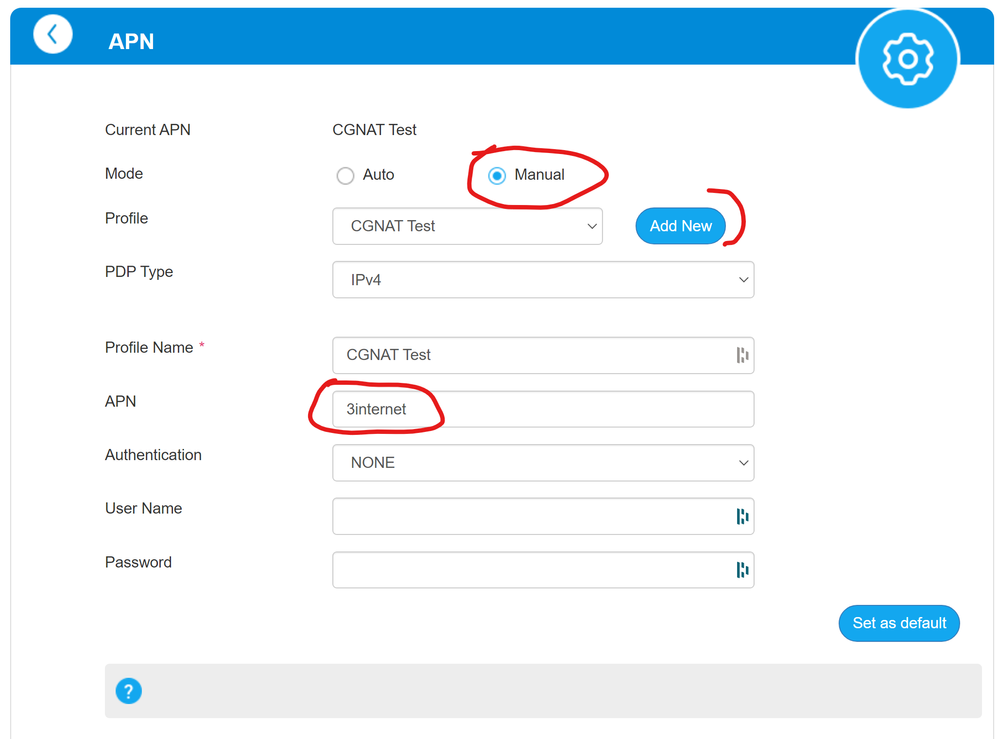

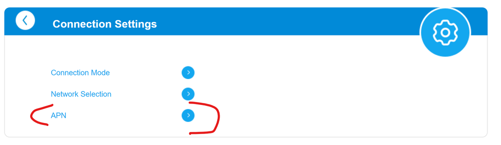

Just to add something here - I came across this conversation while having the same issue myself - My Public IP (188.30.x.x) was showing as different to the one shown in the router -  (192.0.0.x). I checked the advice listed here - and saw that the default profile was set to "3internet" already - but it was said to create a new one - which I did. Literally all that needs to be set is changing the mode to "Manual" and adding "3Internet" to the APN section, then save the new profile - this is identical to the default, however, once set, I could see that my WAN IP in the Web GUI now shows as 188.30.x.x. This solved my issue, I hope it can maybe help others.
For others wanting to set this, log into your ZTE Router - and in the Blue Network Map, select "Settings" under "5G" (or 4G+ / 4G etc, depending on your connection) - in the "My Router" Section. On the next Page select "APN". On the next Page, change the Mode to "Manual", then "Add New" - this creates a new, blank profile. Give the profile a name - I used "CGNAT Test" and "3internet" in the APN section. Everything else can be left blank. Select "Apply" to save it. You just need to make sure that the "Profile" section shows your new profile - I selected "Set as Default" to make sure it always uses this profile.
Once completed, I could see my WAN IP changed to the correct one, and not a CGNAT address (CGNAT SHOULD be between 100.64.0.0 and 100.127.255.255, but maybe Three are using ones outside this scope for some reason - having 192.0.0.x is a big indicator it is a CGNAT address).1.png2.png3.png
