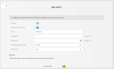

If the APN is detected automatically, set a manual APN profile, still for 3internet APN and set the router to IPv4 only.
This seems to be helping with some device and VPN connectivity issues, so I wonder if it solves this too?

25-05-2024 01:04 PM - edited 25-05-2024 01:05 PM
I am just pulling my hair out right now. I've done everything as above and it is still not working 😪
Or should I add new APN? I've just edited first one.

on 11-03-2024 10:53 AM
This was exactly what solved my problem. I went to 5G settings -> APN and then set up a new APN called "3internet IPv4 only", set the PDP type to IPv4 and then the APN to "3internet" and suddenly all my port forwarding came to life (after renewing my DDNS).
