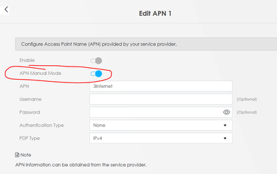

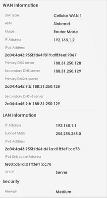

My wife uses VPN for work and one day she wasn't able to connect. I checked the router (Zyxel NR5103E) web-config and noticed the Primary/Secondary DNSv6 server addresses info were present which weren't before.
I tried disabling IPv6 in the WAN and LAN settings but internet service stopped.

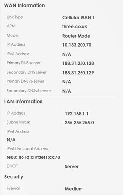

I then enabled manual APN mode and changed from 3internet to Three.co.uk and restarted the router. After restart, the IPv6 info was N/A and the VPN was able to connect. VPN also connected when APN was set to 3internet with manual APN enabled.
The strange thing was when APN Manual Mode was disabled and router reset, IPv6 info was displayed. It looks like the router was obtaining IPv6 and IPv4 info from Three if manual APN mode is disabled. This could be the PDP Type being set to IPv4/IPv6 automatically by Three where as in manual APN mode, I have it set to IPv4 only.

First, log in to the hub from a browser ideally on your laptop (or I guess phone), not the hub app. (ie, 192.168.1.1/login, logging in as admin)
1) under top-right burger menu-->Network Settings-->Broadband-->Cellular APN, I set to manual so it ended up as follows:

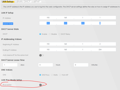

And under Burger menu-->Network Settings-->Home Networking-->Lan Setup, click on the 1st APN setting in the list (on the right-hand side where you click to edit), then
I then rebooted the hub, confirmed settings remained as above, and rebooted my devices (including network switch).  Audio player and speaker when connected to my network switch  do show up on hub app both under Wi-Fi and LAN as expected.
