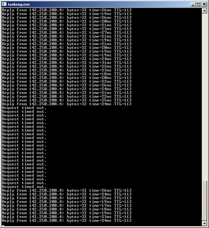

Also, for those who are using a Windows PC, you can run a simple one-line command at start-up that pings google once a second and reports. You can clearly see when it drops out (see attached screenshot). You can minimise the window so that it doesn't intrude. I've attached a screenshot of the Task Schedule for anyone who wants to try it.
Dropout
Ping command
