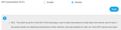

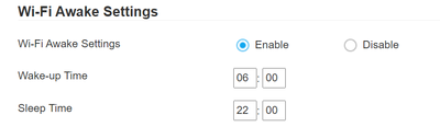

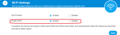

Hi Everyone,
For those of you using the ZTE MC801a, to progress our investigation with ZTE we need to check if a couple of settings are relevant. Can you let me know if the drop outs are still happening with the following set up?
In Advanced settings> Night mode. Please disable "Wi-Fi Awake Settings"
Also found in advanced settings, DFS switch (5GHz Wi-Fi) should be disabled too.
In the basic Wi-Fi settings please enable "Single SSID", and disable "Guest SSID Switch".
Please give these a try and let me know if you're still seeing the same issues.

on 19-12-2022 12:30 PM
Hi @JonathanB,
I don't currently see a setting for Night Mode, likely as I have the SSIDs split. I don't have single SSID enabled as I need it split for my smart plugs etc to work. Guest SSID is disabled.
