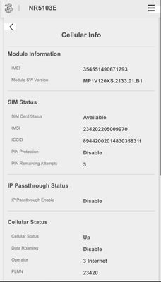

Hi, Can you provide a screenshot of the Cellular Info page in it's current state. It may help to diagnose the problem.
As the SIM is fine, it could just be a bad router that needs replacing.

03-03-2023 11:42 PM - edited 03-03-2023 11:57 PM
please see below for information / screenshots
sometimes if I change the band to another and back it sometimes spring back to life, but only for a brief moment
i though i was making some progress today as it managed to stay on 5g for a few hours but now nothing??
Also if i switch the band to just NG5G-SA the connection drops completely, not sure if this is normal??
