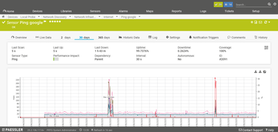

I have had three periods of very bad latency when the hub appears to have connected to a "bad" ip address,  in each case Resetting the hub has caused it to pick up a different IP address with normal 20ms latency
After the first problem I installed PRTG to make it easier to monitor latency and network connections
(graph above wont show until three moderate image)
I am considering if I can automate the hub reset with PRTG  so I may look at your script for inspiration
