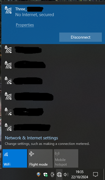

Hi JonathanB, Thanks for you message.
When DNS fails Windows 10 says “No Internet, secured” as in image below. The 2x iPhones say “No Internet Connection” in Settings>Wi-Fi. The 2x Samsung A34’s say “Connected without internet” in Settings>Wi-Fi. All at the same time. All apps and browsers on all devices say DNS issues or simply no internet. If I set any or all of the devices DNS from automatic to manual using 1.1.1.1 and or 8.8.8.8, the “No internet” errors on device go away & internet usage resumes for an hour or two.After rebooting, everything's ok again for another 30 hours or so.
The DNS fails on the router when wired by Ethernet and on Wi-Fi.
Factory resetting the router has no impact and the DNS fails again after around 30 hours or so.
Before the router did an automatic software update, the DNS would fail after 4 to 5 days and factory resetting had no impact and would fail again after another 4 or 5 days.
It’s now on Software Version BD_H3GUKMC888V1.0.0B09
Hardware Version MC888HWV1.0.0
The Network Status Checker says “Our systems haven't reported any network problems.”
And has always said that, when I’ve checked from time to time.
I’m getting good download speeds right up until the DNS fails.
