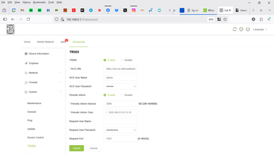

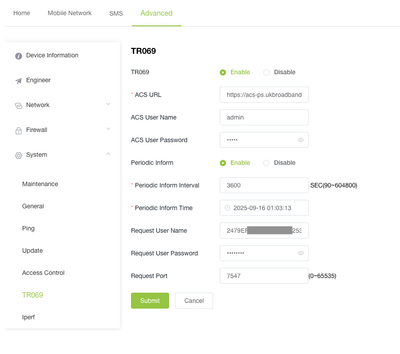

on 16-09-2025 08:38 AM
Original layout:
New layout:

16-09-2025 09:13 AM - edited 16-09-2025 09:17 AM
@lukewest Those 'login failure' messages were your attempt to disable the TR069 service, and there is an invalid '-' in the request user name. Set the 'request user name' field to blank then you will be able to disable the TR069 service (do not change the ACS user name)

on 16-09-2025 12:20 PM
Ha. I didnt think that their default values may have been the cause of the problem.
I removed the "-" and was able to turn this off.
