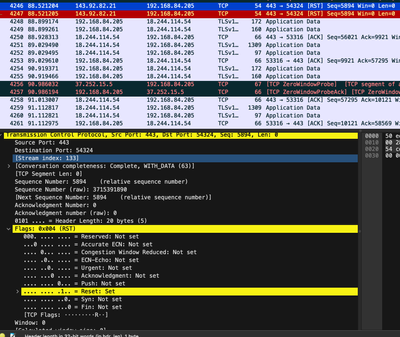

on 16-11-2023 10:21 AM
I've been trying to further diagnose my issue and have the following information that might be helpful:
- Most of my errors are SSL errors or QUIC protocol issues on Chrome
- I see more problems in an evening than during the day - network load related?
- Swapping the IP Passthrough mode does NOT solve the problems
- Disabling IPv6 everywhere in the router config does not solve the problems
- Using external DNS directly from my clients does not solve the problems
This is frustrating as I am in my 30 day returns window and I was hoping to find a faster alternative to my BT FTTC service however it currently isn't reliable enough as I work from home. Is there any option for me other than cutting my losses?
