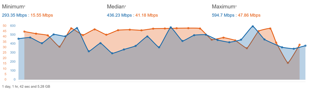

Speeds are now excellent ranging between 300-600 Mpbs with a median of 435Mbps
Not bad considering I was worried whether I would get any signal and the price is much less than I was paying for 34Mbps Fibre 1 😁 😀
