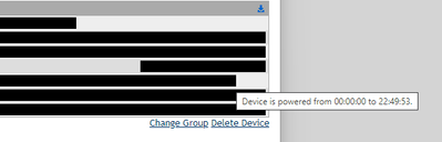

PS just had a look at the data for my Raspberry Pi that's always on and I see it lost a connection to the webservice (so was marked as powered off) at 22:49:53 on 21/6/23 - only returned when I power cycled the following evening when I got home.
