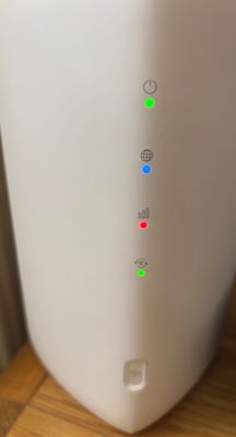

My router also all of a sudden has a red light near the 4 lines which I understand is the signal and the globe icon is now blue.  I have green on power and the lower icon is also green.

These are the lights on my hub.

Your best bet would be to check the Three status page for any tech issues in your area and take it from there.
