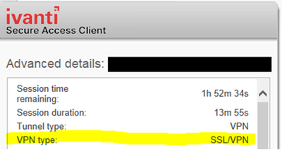

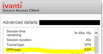

You can see what sort of connection you have without needing to save any logs. From the Ivanti app, select File, Connections, Advanced Connection Details... see examples of SSL and ESP connections below:

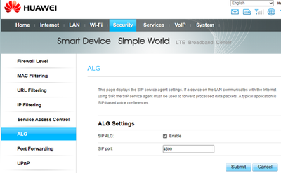

Router: Huawei B593s-22
I found a security setting 'ALG' and told it to use port 4500, and then enabled it - see below:
Success! After changing the settings and restarting the router, my ESP connection always gets these 'missed heartbeats' and reverts to SSL mode after about 20 seconds. So now, using SSL mode, I am able to do my work. However, I don't think this is a fix, it's just a work around until someone figures out what the real issue is - my connections are now good enough for me to do my work, but they do seem a bit laggy and they do sometimes still disconnect after only a few minutes.
