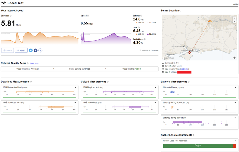

In trying to figure out what's wrong.. i've noticed the Ookla speed test now takes over 50sec to find a server, it used to be a few seconds. The returned numbers however are respectable i think??;
A Cloudflare test is less flattering though!;
i really dont know what to make of it all & it's preventing me working from home. I use PcoiP connections to my work computer & just moving windows around the screen is stuttering & breaking up into blocks.

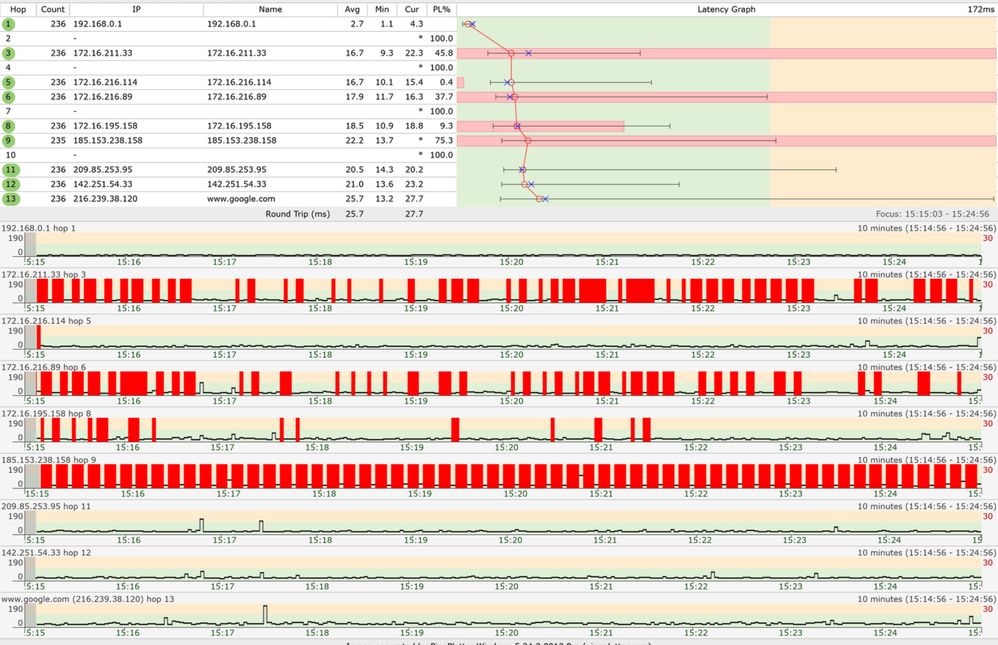

I think my issues are down to network packet loss, is anyone able to have a look at this PingPlotter output from my google.com connection & confirm if there’s a problem with three or if it’s something else? IMG_7596.jpeg
