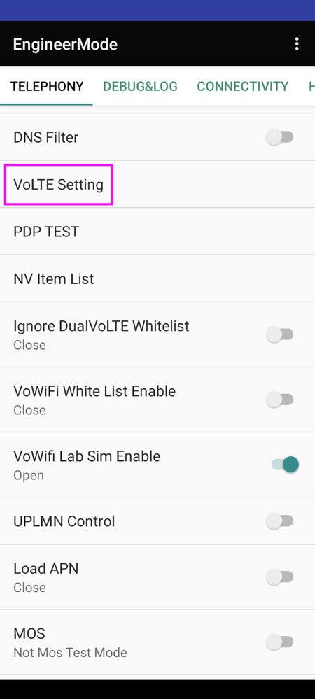

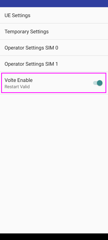

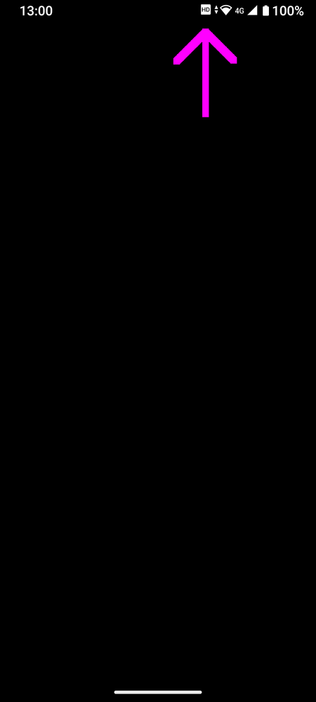

Thanks @JonathanB for your perseverance. I have some good news to share. After much investigation and research, I have found a solution:
Most phones have a hidden "Engineering mode" or "Test mode" that allows advanced tweaks. I accessed it on my phone and changed various settings. Specifically there is a "VoLTE settings" that includes a "Volte Enable" toggle. Nothing changed after playing about with things and doing several reboots. I left the phone for about 30 minutes then when I went back to it there was a new HD icon that I had never seen before. Amazingly I was able to make a phone call from this location for the first time in months. Both VoLTE and WiFi-Calling are working!!!
Engineer Mode
Enable Volte
New icon
New menu option

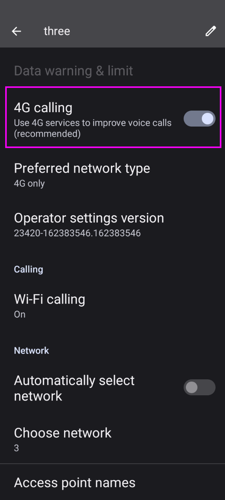

There is "Wi-Fi calling" but cannot see "4G calling"

on 23-10-2024 03:36 PM
Engineer Mode
Enable Volte
New icon
New menu option
