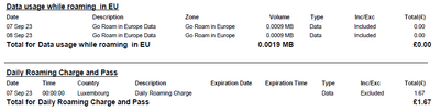

Last time I was in Luxembourg, had Roaming disabled on the 3 SIM but was charged for 0.0019Mb of data (see below)
This time I was visiting the USA.  Before leaving the UK I made certain Roaming was disabled and also turned off the 3 SIM.  I thought the problem might have been the network in Luxembourg so one day while there I turned the 3 SIM on briefly to test and almost straight away got a text from 3 saying I would be charged.  This then appeared on the monthly bill which shows the same 0.0019Mb (this time much more expensive than the EU!)
I'd really like to be able to receive calls whilst away but not be charged for roaming data.
I'm not sure if the problem is with 3 charging for data that wasn't used or a bug in the iPhone (I've a 14 Pro running the latest OS) which means it uses some data even when Roaming is turned off.  I read somewhere that it could be Facetime/iMessage using data to register the phone number as active.
It would be great if Apple could fix the bug or 3 didn't charge for such tiny amounts of data.  Maybe 3 are being charged by the overseas telecoms companies, so it isn't their fault.
