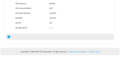

Walkertron
Exact same issue here since Three upgraded the ZTE firmware to B12. Unexplainable drop outs which are massively effecting ability to WFH and dropping out mid call. I too have a strong 5G signal. I've already tried all the steps. Reset the router multiple times and swapped out the SIM card with my 3 5g mobile. Still happens.
Considering cancelling my contract as it is unworkable for me.
