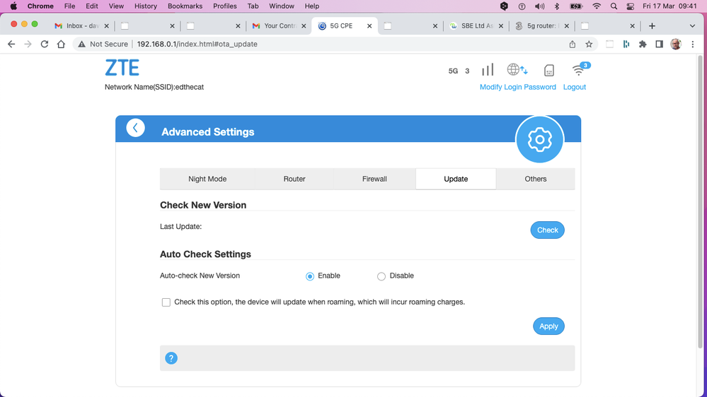

The firmware it is running is: BD_UKH3GMC801AV1.0.0B12
on 17-03-2023 09:43 AM

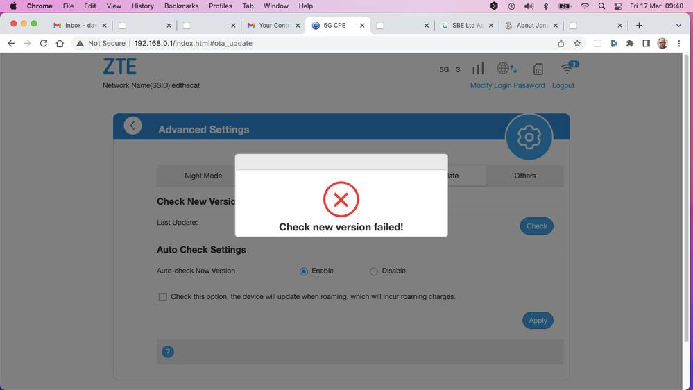

In settings, Auto Check is on. When I click Check New Version it returns "Check new version failed!".
