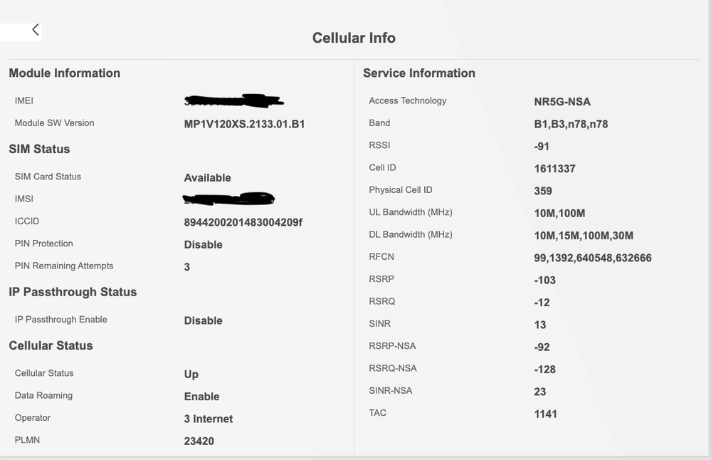

Just received my 3 NR5103E 5G Hub and set it all up today. Absolutely gobsmacked at the download speed (all tests using Ookla Speedtest on my iPhone 13 in the same room as the 5G Hub). I'm getting between 280-300 Mbit/s in the afternoon, and 180 Mbit/s now in the evening, but the upload speed is very poor, it was 0.78 Mbit/s earlier, and now it is saying 0 and all the devices are saying 'No Internet Connection'.
I'm in CR0, and the network checker says that there is ongoing work in my area. Could it be this? Will it be like this every evening?
Is there anything I can change/check on my 5G Hub?

Hi @davidg_croydon,
Could quite possibly be related to some ongoing issues in your area if that's what appears on the checker although there's a few things we can check and try out.
Can you post a screenshot of the Cellular Stats page via the NR5103E admin portal?
Would like to have a peek at your connection stats and check out the cell you are connected to using CellMapper in order to see what bands are being broadcasted in your area etc.
You may be able to test out some band locking combinations via the admin portal once we know what bands are available in your area (you can just go for it and try various combinations if you want, Three mainly use B1, B3, B20, B28, B32 and N78 at the moment but not all masts broadcast all of these bands, its differs by area and ongoing rollout work).
Many including myself have had great success with band locking to increase speeds, especially upload speeds.
In my case my router was auto connecting to B1+B3+N78+N78 which had great download speeds but upload speeds were not good (sub 10mbps), and like yourself, would take a big hit during peak times.
After a load of testing with band locking combinations I ended up with a B28+B3+N78 combo which gives me slightly slower download speeds than before but a much better and stronger signal, lower and more stable ping, and upload speeds now 40-55mbps consistently.

Hi @davidg_croydon,
You should receive email notifications once you've verified your email address with the community. Check your emails from when you registered, and it may be worth checking spam/junk too.
I've had to reject the image too, it's best not to share your ICCID. If you mask that along with the other info you'd already blocked out, we should be able to approve it.

on 15-03-2023 10:22 AM
Thanks JonathanB
Reposting amended image.
