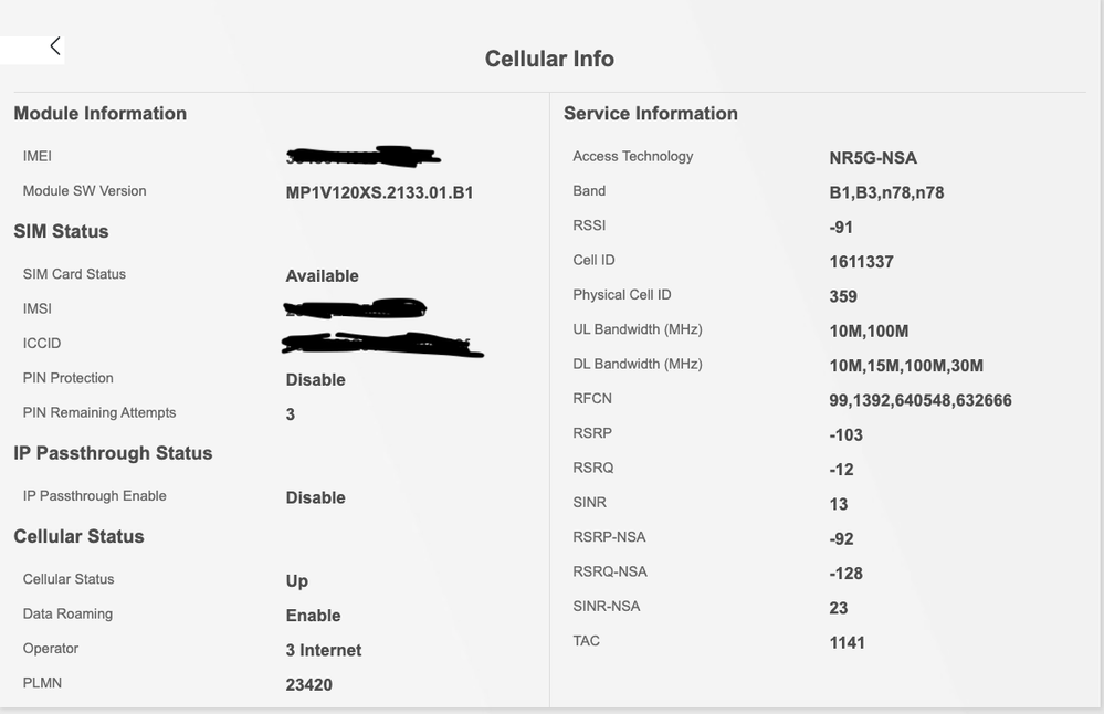

Can you post a screenshot of the Cellular Stats page via the NR5103E admin portal?
Would like to have a peek at your connection stats and check out the cell you are connected to using CellMapper in order to see what bands are being broadcasted in your area etc.
You may be able to test out some band locking combinations via the admin portal once we know what bands are available in your area (you can just go for it and try various combinations if you want, Three mainly use B1, B3, B20, B28, B32 and N78 at the moment but not all masts broadcast all of these bands, its differs by area and ongoing rollout work).
My Post code is CR0 ***. I was told by 2nd line that my nearest tower was 500m North-east of me. My Hub is already on a window ledge facing East.

I've had to reject the image too, it's best not to share your ICCID. If you mask that along with the other info you'd already blocked out, we should be able to approve it.
davidg_croydon
Regular
Reposting amended image.
