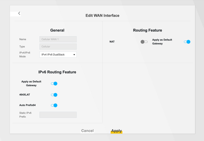

1. Go to Network Settings -> Broadband -> Broadband tab and edit Cellular WAN 1. Switch off NAT.

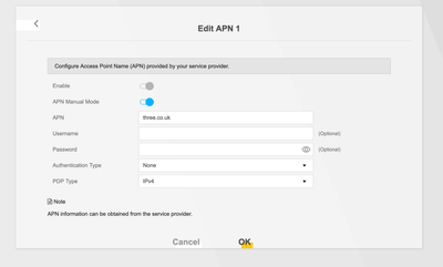

2. Go to Network Settings -> Broadband -> Cellular APN tab and edit the first one in the list. Turn APN Manual Mode on and then change the APN to three.co.uk and switch PDP Type to IPv4.

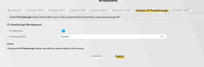

4. Go to Network Settings -> Broadband -> Cellular IP Passthrough tab and switch it on. At this point if you go back to the Home screen, you will most likely still see a local IP address in the Cellular Info, probably 192.168.1.2. It will probably also report that it has lost connection to the internet.

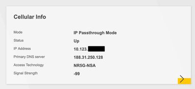

6. Once the router has restarted, look again at the Cellular Info and it should show your WAN IP address, something like 10.123.xx.xxx or similar. The Status should also say it is Up.

- The internet icon on the top of the Zyxel should be blue in IP Passthrough mode. Don't assume it isn't working because it hasn't gone green yet.

One caveat for me was that I had to enable NAT for Cellular WAN 1. With this option disabled, I couldn't connect to the internet on my personal Huawei router or log in to the Zyxel router dashboard.

Why did you need to make the change to  set APN Manual Mode on and then change the APN to three.co.uk and switch PDP Type to IPv4. I would have thought that just setting IP passthrough mode and disabling any forewall would give you what you want. Then your Wifi device(s) will have full control on security etc?
jamesmarkcook
Active
IP passthrough doesn't work for me until I change APN to those manual settings. I got that idea from other threads that mention manually setting the APN. Apparently the default one with IPv6 has some compatibility issues with IP passthrough. I'm not knowledegable enough to know why that is.
