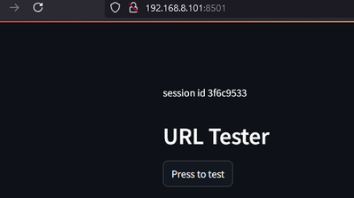

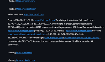

@JonathanB
If its any use, I have a small web (streamlit) app making use of an old Raspberry PI. This would allow your network engineers attempt to trigger the SSL errors when they wanted, without needing anyone else 'on the line'.. PM/reply if you think this would be useful and I can provide access information.
On a button press it runs though a list of pre-defined URLs and reports if any errors occur.
This is running from my own Three connection. Currently, I don't think I'm getting as many errors as other users though.
