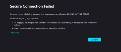

Is anyone else occasionally getting a 'connection down' error from Chrome (or 'Secure Connection Failed' from Firefox) when changing page - if I hit refresh it works fine. At first I wondered if it was the site I was using but have noticed it on multiple different major websites over the past couple of months and not noticed it from other locations where I don't use Three Broadband so does seem to be related to the router/connection (this is via wired Ethernet too, so not a WiFi problem).  I've tried changing DNS server in case that helps but no difference.
It mainly seems to happen when trying to first load a site or (annoyingly) at checkout when a different site is being loaded as part of the checkout process.  It certainly doesn't happen everytime but does happen with reasonable frequency.  I've also noticed I often get it when trying to pull/push from/to Github too and have to do so a number of times for it to work (browsing the Github website works fine).

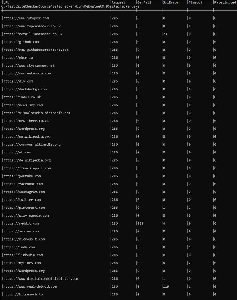

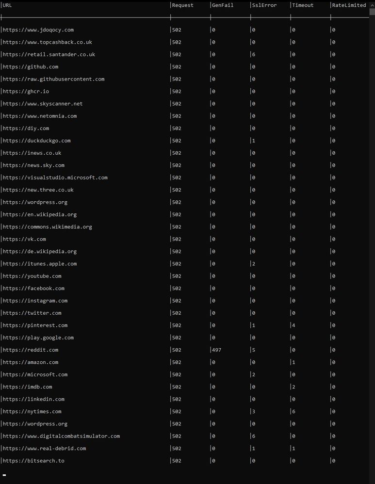

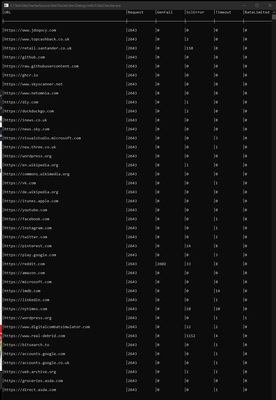

Since I have access to a large number of media and news outlet URLs I thought I would run the top 100 with @wgen's script.
news.yahoo.com 6/20
style.yahoo.com 4/20
road.cc 11/20
respectyou.me 12/20
thesethreerooms.com 1/20
www.liverpoolecho.co.uk  1/20
metro.co.uk 1/20
www.gazettelive.co.uk  1/20
Granted these could just be adding noise to the issue.
