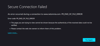

Is anyone else occasionally getting a 'connection down' error from Chrome (or 'Secure Connection Failed' from Firefox) when changing page - if I hit refresh it works fine. At first I wondered if it was the site I was using but have noticed it on multiple different major websites over the past couple of months and not noticed it from other locations where I don't use Three Broadband so does seem to be related to the router/connection (this is via wired Ethernet too, so not a WiFi problem).  I've tried changing DNS server in case that helps but no difference.
It mainly seems to happen when trying to first load a site or (annoyingly) at checkout when a different site is being loaded as part of the checkout process.  It certainly doesn't happen everytime but does happen with reasonable frequency.  I've also noticed I often get it when trying to pull/push from/to Github too and have to do so a number of times for it to work (browsing the Github website works fine).
I'm using a NR5103E with Firmware Version V1.00(ACBJ.0)b14 - I tried rebooting it but to no effect.

I've encountered the same issue, which has escalated notably in recent months. I tried different approaches, including changing web browsers, modifying SSL/TLS settings in about:config, and testing various DNS servers. My internet connection is established through a ZTE MU5001 (5G) router, directly connected via an ethernet cable. Notably, parental controls are disabled. This problem has also led to occasional difficulties in form submissions, causing the loss of work on multiple occasions.

I've also seen the same intermittent errors for a few months. Initially I thought it was the browser (I was using Firefox; as someone mentioned, Chrome does some retrying and the problem is less obvious). Then I realised it happened on the command line and in other apps as well.
I believe it's the same issue mentioned here:
https://community.three.co.uk/t5/Broadband/Three-5g-broadband-random-request-connection-issues-paren...
In that thread, the OP mentions that switching to 4G fixes the issue. I can report it works for me as well, though of course it cannot be a long-term solution.
While on 5G, the "Cellular Info" section in my router's UI reports NR5G-NSA as Access Technology, and a RSSI of -89.
I'm using the following one-liner to test; it uses Curl to connect to github.com 10 times, ignoring the output but printing any errors. I'm attaching a screenshot of its sample output.
for i in {1..10}; do curl -I --no-progress-meter -o /dev/null https://github.com || true; done;
3 failures out of 10 connection attempts3 failures out of 10 connection attempts
