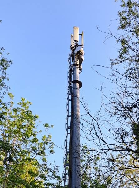

I selected lock bands B1, B3 and N78 but sadly it went from 5G convert back to 4G with B3 because the mast was closer to mine is boring slow 4G B3 at all times with download speed of below 20 and upload speed of below 25. Three need to upgrade nearby my mast 4G with B3 to add B1 and 5G on it. But, they won't bothered. This is 4G mast below approx 350m away from my house. 4G strongest signal -70 can ruined my 3km away (5G mast) refused to connect it because of B3 nearer my 4G mast only to pick up 4G all the times. I have to use locked B20, N78 but download speed of 350 and upload speed of 5. Locked B1, N78 get download speed of 450 to 550 but upload 7 to 17. I have to leave B3 unselected.
