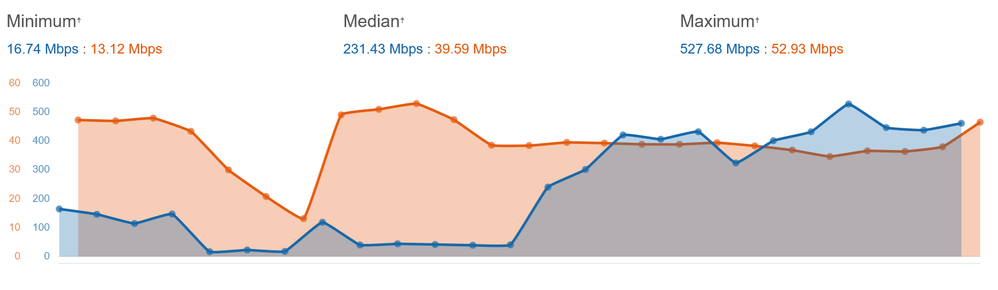

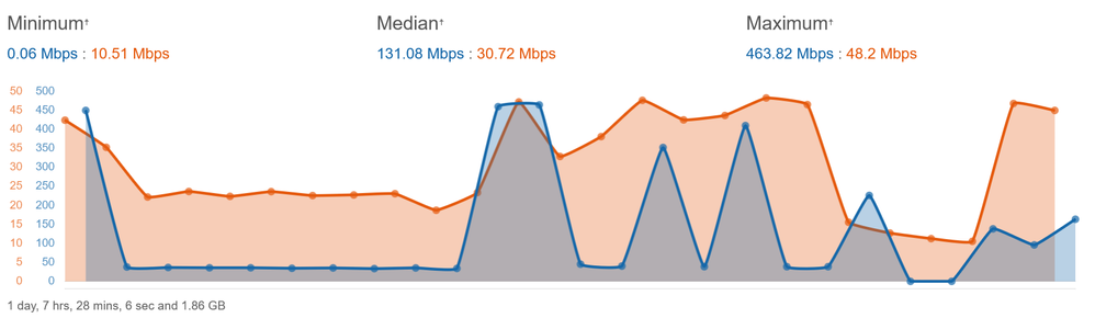

I have been monitoring my download and upload speed and they have improved since I mounted my hub on an external pole but they are still very inconsistent
I am still looking for a way to monitor my signal strength on a regular basis.
I can see current 5G signal strength on the hub web page https://192.168.0.1/#/home and it seem to range between 75 and 85.  But I still haven't found a way to collect that data on a regular basis so that I can try to correlate it with the speed test results

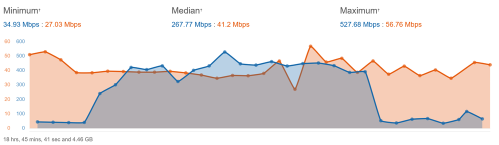

After moving all my wired connections from my old PlusNet routers to gigabit  switches I was able to start trying speed tests over a wired connection and this clearly show that I am able to get a consistently excellent speeds of 300-600Mbs, median 436Mbps, throughout the day and my concerns about signal strength are unfounded 😁
But I am still getting very inconsistent speed using wireless connections, why?
All of my testing is done with a laptop (Win11 pro) in the same room as eero with power connected so the variations are not due to signal strength or power settings, there is negligible other wireless activity (.1MBs) on the PC so the problems are local to my PC,  turning wifi off and on produced a short term increase in speed.
Resetting the wireless adapter by disabling/re-enabling it seems to have had a more positive affect, touch wood whether the improvement lasts
I will continue monitoring
