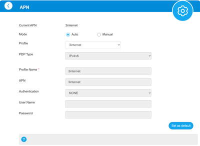

@JonathanB As mentioned before, my APN was set to 3internet but was set to Auto, I've just changed it to manual and then manually set the APN to 3internet (so ostensibly no difference in the actual setting) and sure enough, when I switched it back to bridge mode it is now working again. So it seems like, even though it says it is using the correct APN when set to Auto mode, it actually isn't. Either that or manually setting that particular setting causes another one to be reset.
Whatever the cause, it resolves the issue and I now have my own firewall working properly, no double NAT and performance back up to 930/135 where it had been 500/100 without bridge mode.

on 26-04-2023 02:23 PM
Hi Jonathan, mine is set to 3internet already:
I'll try changing it from Automatic to Manual though and see if that makes any difference
