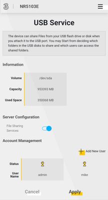

When a USB drive is connected to the USB port, the web-based config (Network Setting > USB Service) doesn't display options to share folders. The page shows Volume as /dev/sda, Capacity and Used space are shown for the drive so it's recognised by the router. File Sharing Services is enabled and applied. I'm expecting a File Sharing / Add new share option but this isn't available. Firmware is V1.00(ACBJ.0)b12 which is currently the latest.

Hi, Can you provide a screenshot of the USB Service page from within the router web-config? Thanks.
Mike20490420
Regular
 Here you go.
The same information is displayed if I log in with my laptop.

Although we are now able to access the USB drive for sharing, I think there's still a problem with the USB Service page as it says, "You may Start from deciding which folders in the USB disks to share..." and we can't do that. So either they have decided to implement the way we are accessing the drive at the moment (\\191.168.1.1\usb_share) and haven't updated the instructions or they haven't properly implemented the feature/function to share folders. Hmmm.

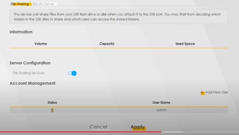

The volume entry /dev/sda shouldn't exist when no storage device is plugged into the USB port like below for another Zyxel router.
