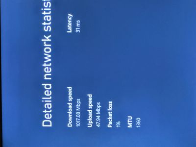

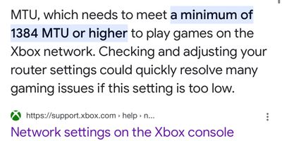

I am struggling to get my Xbox to work on Xbox live. Doing some googling it seems that the MTU is too low, it is 1360 and should be about 1385 to be able to work properly. I have rung three who seem to have no knowledge of what an MTU is and have sent me to the ombudsman. I have logged into the router (H122-373) and increased the MTU manually however it will not pull through onto my XBOX. I have put it in the DMZ, enabled UPNP and generally faffed with it as much as i can but the MTU on the XBOX does not change. I am assuming this is what is being sent from three and so it is something to be changed at three's end...

I've seen several posts floating around the internet where people are having MTU issues when using 5G networks to connect to Xbox Live.
I currently own the 5G Home Broadband. I'm having the exact same MTU issue. When testing my connection my MTU is 1360. People are reporting they can change the MTU manually in the router settings but I couldn't seem to find the option to do so.
