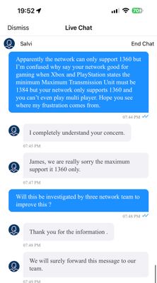

I've seen several posts floating around the internet where people are having MTU issues when using 5G networks to connect to Xbox Live.
I currently own the 5G Home Broadband. I'm having the exact same MTU issue. When testing my connection my MTU is 1360. People are reporting they can change the MTU manually in the router settings but I couldn't seem to find the option to do so.
I was just wondering has anyone fixed this ongoing issue? I've seen reports that date back to the beginning of this year with still on going solutions.

Is there any update on this?

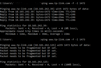

Hmm, interesting but I get a MTU value of 1500 (1472 + 28) with a Ping test from my PC.
How to find the proper MTU size for my network | TP-Link United Kingdom
Can someone with a MTU value of 1360 on their Xbox, try the ping test from a PC?

Is there anyways this can be fixed or should I cancel and go elsewhere?
MrSimo98
Active
Currently there seems to be no way of fixing this as it's a problem with Three directly. People are raising concerns about this issue daily but little response seems to be coming back. It's such a shame because my personal experience speeds are great, but the MTU problem is limiting online play drastically.

JonathanB mentioned in this post that the MTU is set by Three so changing on the router won't make any difference.
MTU for XBOX live mutliplayer gaming on 5g home br... - Three Community - 5113
If you have a PC, you can perform a Ping test to find out the ideal MTU size : How to find the proper MTU size for my network | TP-Link United Kingdom
Have you tried connecting the Xbox to the router via ethernet cable?

Jonathan has mentioned that the MTU value is set by Three and it appears to be 1500 from the Ping test. I just want to mention that changing the MTU value in the ETHWAN entry will make no difference as this only applies if using the router LAN2 as a WAN port and connected to a modem/ONT/ONU for a FTTP connection. ETHWAN is disabled (shown in the Traffic Status page) as the 5103E is using cellular WAN.
